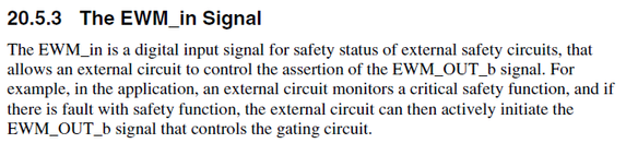

2. If EWM_in is enable,the EWM_in looks like must input the same frequency square wave as the software refresh EWM frequency and EWM_in should de-assert when feed dog to avoid assert EWM_out. The picture below shows:
 However,the EWM module clock source is LPO,so the EWM_in's clock source also should be it,otherwise, if LPO clock and EWM_in's clock is asynchronous,the EWM_out will assert in the future.

The EWM_in input allows an external circuit to control the assertion of the EWM_out signal.
If there is a fault in the external circuit, the EWM_in is asserted, otherwise it is deaserted.
