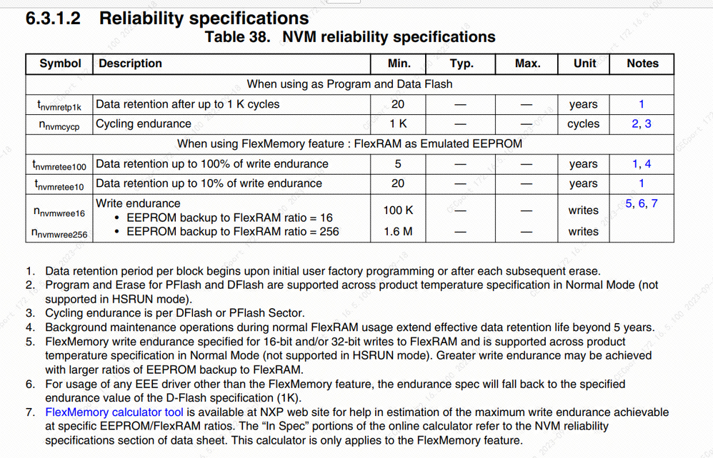

I found the following data in the data sheet, is it mean:
1. use data flash,erase timing 1000?
2. use data eeprom , erase timing 100,000 or 1.6m ?

PetrS
1) yes it is minimum quarantied program/erase cycles per flash sector
2) it is minimum guaranteed writes (32-bit) for given EEPROM backup to FlexRAM ratio.
You can refer to Flex Memory Endurance Calculator where you may choose written data specification (no. of updates, records, data size) and see how it affect endurance.
https://www.nxp.com/downloads/en/calculators/FME-Calculator.zip
For more information about the EEPROM, please take a look at AN11983 Using the S32K1xx EEPROM Functionality; https://www.nxp.com/docs/en/application-note/AN11983.pdf
BR, Petr

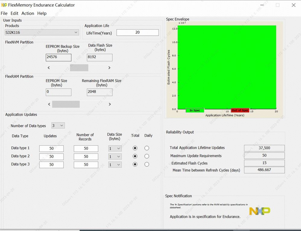

691 Views
jingfang
I found this tool that day, but how to adjust,no change,how should this tool be used?
658 Views
PetrS
a usage is described in its UserGuide; Help->User Guide
BR, Petr
