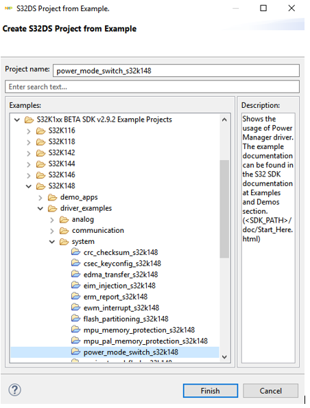

There is this power_mode_switch_s32k148 SDK example in the S32 Design Studio.
The MCU wakes up into either RUN mode or VLPR mode, depending on the system mode prior to VLPS.
Instead of this function POWER_SYS_SetMode(RUN, POWER_MANAGER_POLICY_AGREEMENT);
You can use POWER_SYS_GetCurrentMode() in the ISR to check the current mode.
The function reads the Power Mode Status register (SMC_PMSTAT).
