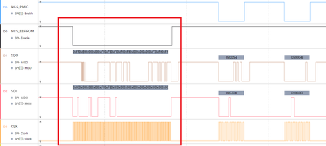

Now I want to change the different configurations after the EEPROM page-write(256 bytes) transmitted completely, how could I make it?
About 16 bytes transmitted and then  SPI0 deinit.

What's the value of u16_len and u32_timeout? If time expires SPI_MasterTransferBlocking()  will return error and the transmission will be aborted. Did you check the return value?
Robin
2,725件の閲覧回数
Leon_Hsieh
Hi Robin,
I didn't check the return value yet.
I set the value u16_len = 260U,and u32_twmeout = 10U.
For testing, I close PMIC SPI and only EEPROM SPI active.
Also, I trace that the SPI messages fully transmitted is taken about 2ms.
Leon
