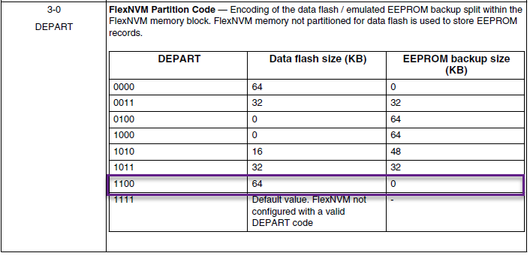

Question 1: Is it a correct approach to make complete 64KB of FlexNvM as D-flash to run code from it?
Question 2: What should be the partition value that needs to be filled in advance debug option?

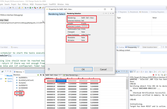

Now when I tried value 0x0F0C with PEmicro Debugger I get the following error:
I even tried Emergency Kinetics recovery but still I get the same error.
Now I am not able to flash any code on the Pflash.
One weird thing that I noticed in that there is no data at address 0x00 also this address is shown as false for reading and writing.
Whereas my output file starts from 0x00 address, can this be an issue that is causing the flashing process to fail?

A1.
If the whole FlexNVM or just a part of it is used as DFlash, you can execute code from it.
A2.
I just tried the 0x0F0C value at it correctly partitioned the FlexNVM for 64MB of DFlash.
