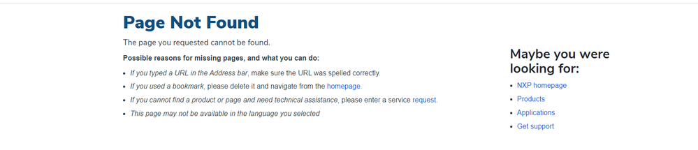

Hi, I clicked and found out the link is not working anymore, can you share a working link again?
6,616 Views
Dhwani
I cant open the link provided here. pls share the correct link
When I click this link: AN5401 Getting Started with CSEc Security Module or AN5401SW.zip System gives below response.

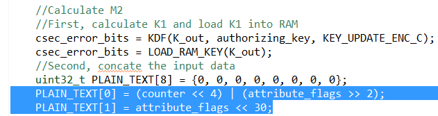

ummerkunnummalk
Hi danielmartynek,
      In the sample code, the key counter and attribute flags are being bit shifted before loading into PRAM for calculating M2. Could you please explain this? Can you please guide me to any documentation with respect to this?

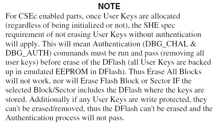

veronicavelciu
Hello Sudarshan,
Please check the following note from the RM:
So, the flash configuration field you mentioned in your comment, would need to be written immediately after step 1 (erase all block), otherwise the chip will be secured after the next reset.
Considering the attached note, mass erase will not work anymore.
I would recommend using the csec_keyconfig example in the S32 SDK, which shows how the Flash should be partitioned for CSEc usage.
Veronica
