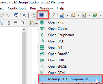

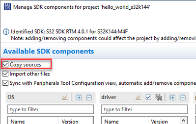

Hi @ajain33555
if my understanding is correct, you need to have all the RTD or SDK files included directly in your project and not just linked, right?
If so, please follow this if you have older version of S32DS with Processor Expert:
https://community.nxp.com/t5/S32-Design-Studio-Knowledge-Base/HOWTO-Use-SDK-based-example-code-as-st...
If you have S32DS 3.4 and higher, it can be configured like this:
Lukas
