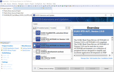

Can anyone please share me the steps to compile Unified bootloader from S32K344 controller by using S32 Design studio? I have downloaded Unified bootloader from the below link, But I am new in S32 Design platform. Please help share me steps to compile it.

this demo software environment is S32 Design Studio for S32 Platform V3.4 + RTD 2.0.0
you can download the software in the link below, after install the IDE,you still need to install RTD 2.0.0.
https://www.nxp.com/design/software/development-software/s32-design-studio-ide/s32-design-studio-for...
some helpful answer for your reference,the step was same to install V3.4 and RTD 2.0.0
