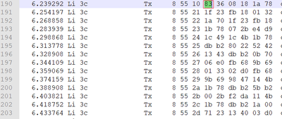

I am working with your Unified Bootloader for S32K116_LIN. Which use the UDS Process with CANalyzer but I have a problem, I received a log of LIN communication from an NXP Support and I followed the same steps but after downloading the Flash Driver I only see that the APP_Demo is downloaded in RAM (0x200021C0) but I never see that is passes to the Flash memory.
After Erase Memory I saw that only the RAM is erased (from 0x20002FF0 onwards) and not the Flash.
The problem could be that I don't use the OpenBus tool? or Can it be a problem of the Erase Memory Function?
Thank you in advance.

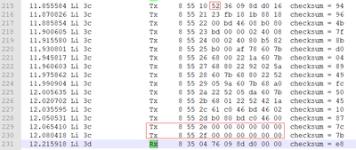

RGMAL
I attach my LOG but in these steps (download or verify(CRC) flash driver) I have no Negative Response.

nxf10035
     From the log, the problem is erase P-flash failed.

nxf10035
   I found an issue for PC tool. Default, bootloader program flash data align with 8 bytes, max data length is 128 bytes. For the PC side, send message data must align with 8 bytes, send max data is 128B(0x80). For 0x36 service, send message length should set 0x82. For flash driver maybe have not problem, for APP have an issue.

RGMAL
I changed the message length to 0x82 but I saw the same error in Erase Memory.

RGMAL
I worked with your boot loader and saw the same error in Erase Memory and saw the same error in the last Routine Control (31 01 02 02) I got as a response 71 01 02 02 01.
I attached a log.

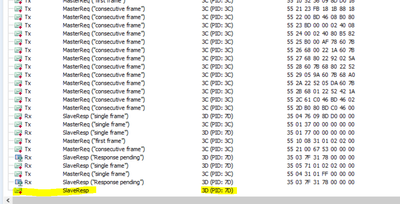

nxf10035
   Did you have test over PEAK(NXP provide the open BUS tool). I saw some issue as below:
 The PC tool not following LIN TP spec.

RGMAL
Yes, I have tried with other boards and also delete all P-Flash.
Right now I am testing with the new Bootloader but I have problems with Erase Memory, I saw these values.
I am using evaluation board (S32K116 EVB).
If I put a peak point I can see the answer, but in my GUI the slave does not answer me.
