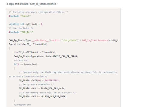

Thanks for the speedy reply! When I tried compiling the flash bin file, I got an error saying Mca1.h and C40_Ip.h was not found. Moreover, my linker files looked very different compared to the image. Should I create the project as a new S32K application or am I missing any steps during project creation?

1.This is an article I wrote before to explain what flash bin is.
https://community.nxp.com/t5/S32K-Knowledge-Base/S32K-How-to-make-Flash-Driver-image/ta-p/1630873
2.I have clearly written how to create a flash bin file in the comment on the link you provided, and the source file is also in this comment.
