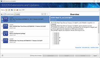

Hi @M_SCH,
I have installed S32K1 RTD 2.0.0 QLP1, and I was not able to find the define _GCC_C_S32K1XX_ you are mentioning:
I can also see you are using gcc 9.2, which is not the default compiler for RTD 2.0.0. Could you share your installation details?
Is this issue also present when importing the ADC example?
Julián

I was able to solve the issue by my own.
To clarify:
I have uninstalled the RTD v2.0.0 P03 package and installed the latest package named QLP1. I checked again and realized that the ConfigTool does not detect a change in the RTD and therefore the RTD library inside the existing project was not updated (file header still indicated P03). I then setup a new project based on the RTD v2.0.0 QLP1 and made the necessary adjustment.

Hi @M_SCH,
Currently S32DS does not support more than 1 RTD package for the same product installed. In order to update packages, the previous one must be uninstalled.
Julián
