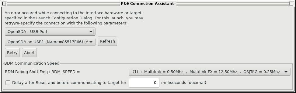

I've got a development board with S32K146 which seems to be somehow corrupted. It worked correctly some time ago, but now I cannot reprogram it with S32 Design Studio for ARM. The result under S32DS is like this:
and it is not possible to program the MCU - because after click on Retry this window appear again and again.
I suspect that something went wrong when I tried to program the MCU with copying some .srec file using Mass Storage programming method.

J-Link debugger cannot connect to this MCU - even it can't recognize the MCU. The screenshot I attached in my first post is taken when I tried to load application from S32DS via OpenSDA.
I'm afraid I secured permanently the MCU because I've made some mistake in my linker script and probably the area 0x400-0x40f has been overwritten by binary code. So everything could be placed there.
Seems like the only option is to solder new MCU now? Am I right?

These are the SWD connection steps described in AN12130 Production Flash Programming Best Practices for S32K1xx MCUs.
In this case, however, the Flash Ready bit (Status[1]) is not set and the mass erase operation (control[0]) can't complete for some reason. I don't think there is a solution other than replacing the MCU, unfortunately.
BR, Daniel
