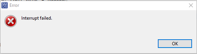

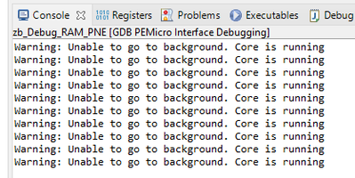

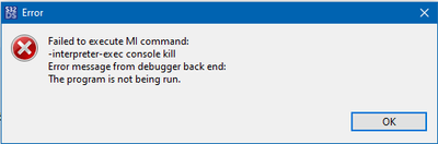

Can you share a screenshot of the error message?
After suspenging I get those errors:
After terminating I get this error:

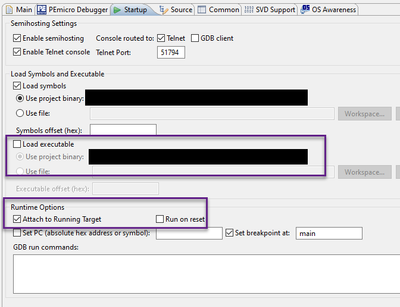

But you said that you reset the MCU after it has been flashed, and debugging after that is not possible.
Do you attach the debugger back to the MCU after the reset?
Was the HSE_FW installed on the MCU?
BR, Daniel
3,122 Views
wyzykpimot
Little misunderstanding because of my wording. What I meant was:
After Debug_Flash the problem still exists. What I do know is that at least part of the debug session worked. Why? Because after I reset microcontroller, it starts executing the program I flashed in Debug_Flash. I cannot connect to the microcontroller after resetting too.
After using the configuration you suggested and connecting to the MCU after the reset I get following informations:

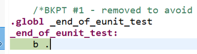

When I suspend the debug session, it always shows this line of code:
Which is located in startup_cm7.s

I pasted the first line:
    /*BKPT #1 - removed to avoid debug fault being escalated to hardfault when debugger is not attached or on VDK*/ /* last instruction for the debugger to dump results data */
