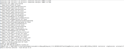

Hi NXP Support team,
I am unable to start a debugging session with my PEMicro Unversal. I get the following console output error messages: Screenshot 2025-05-14 092418.png

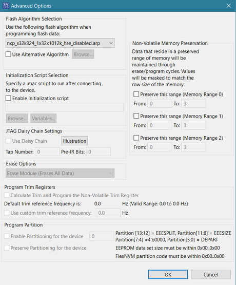

Previously it all worked fine, but for some reason all of a sudden it is unable to launch a session. I connected the TRACE32 debugger to check if I can debug with it, it said that the target is "locked up". I also tried to use the "Emergency Kinetis Device Recover by Full Chip Erase" but it just displays a message that this is not supported. Also I have not messed with any debug/flashing configurations or algorithms. Is there a way to erase the MCU or to "unlock" it? Below is my debug configuration: Screenshot 2025-05-14 093329.pngScreenshot 2025-05-14 093313.png

The log says, error during flash programming.
What about just attaching the debugger?

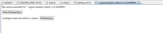

Attaching results in the following output:
Pressing resume and suspend changes nothing. Instruction is always stuck on fffffffe. Target is not resetting, reset line is high all the time. JTAG does not work as well. I've tried to flash and debug with PEMicro and Lauterbach, both do not work. No HSE FW was installed or used.

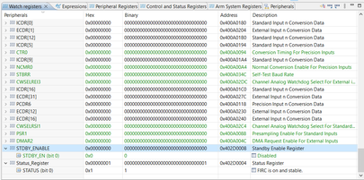

When attaching with PE micro:

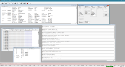

When trying to flash with Lauterbach:
Flashing error message is highlighted and the status says "running (locked up)". Unable to click the attach button at all. Other buttons as up and down are working it is just impossible to select.
