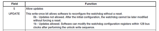

Senlent
Hi@KKumar
please check bit CS->UPDATE .
