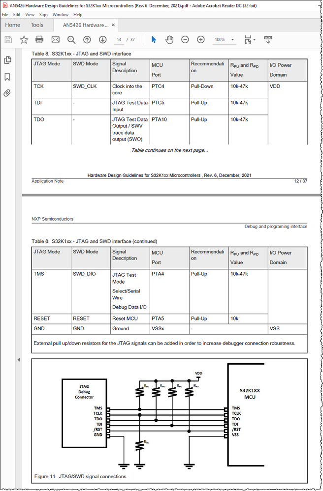

Robin_Shen
Please check the SWT interface: note the pull-down resistor added externally to the SWD_CLK pin.

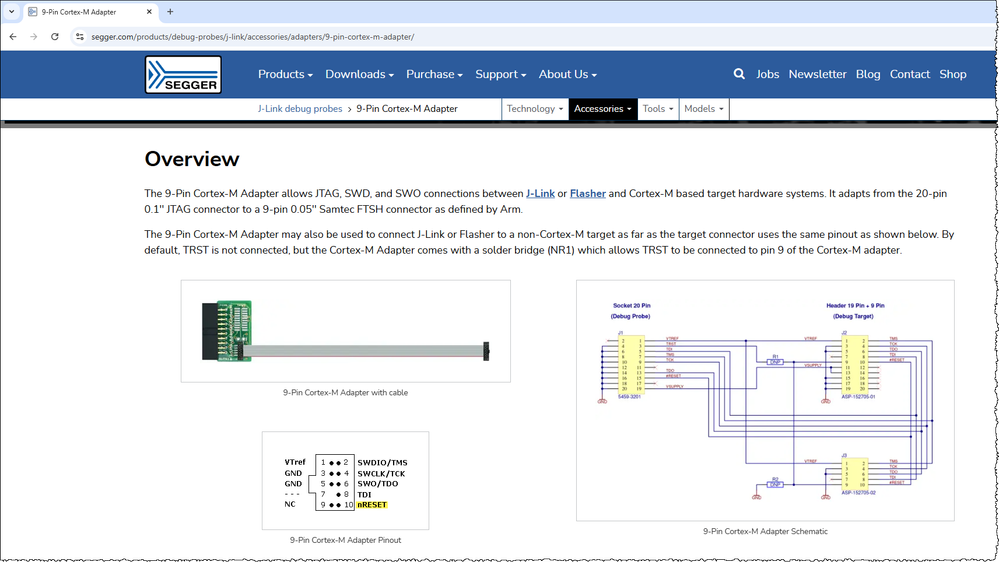

If you are using the 9-Pin Cortex-M Adapter, please make sure that the RESET signal of the S32K144 is connected to the nRESET signal(pin 10) of the J-Link.
Then refer to the discussion in Unbricking S32K146: pull RESET low, then use the J-link commander and these commands to try to connect.

297 次查看
srinivasaraomannem
we have 10k pul up at TMS,TDI,TDO
10k pull down at TCLK
4k87 at reset
