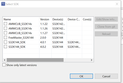

I have install AMMCLIB to S32 DS and able to integrate with NXP GCC 6.3 Compiler.
I can see various above option if I select GCC6.3 Compiler

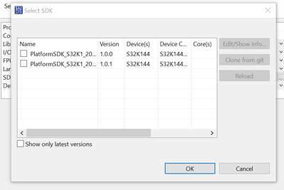

But no AMMCLIB sdk option once I select GCC 9.2.
How can I integrate AMMCLIB SDK with GCC9.2??

PetrS
recent AMMCLib SDK supports GCC6.3 toolchain so it will not appear if GCC9.2 is selected.
