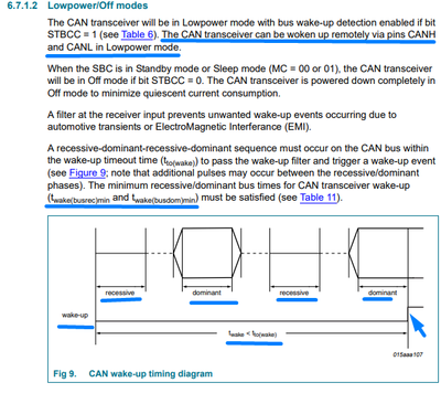

I am using UJA 1076 and I put it to sleep mode. So I need wake-up sequence remotely.
According to the application note attached below, how should the wake-up message be?
What should the message ID of the CAN message be?
Should the time between frames be 0.5 - 3 us?
Is the message to be sent [0x01,0x00.0x01,0x00] without message ID?

Dear Ufuk,
I didn't mean to send a CAN wake-up message to the UJA1076A. You have more devices on the CAN bus at the same time. While the UJA1076A is in Sleep mode and you communicate with other devices on the CAN bus, the UJA1076A unwantedly wakes-up. Is that correct? To wake-up the UJA1076A (willingly or unwillingly) you don't need to send any request. Just the pattern in the Figure 9. must appear on the CANH and CANL pins.
With Best Regards,
Jozef

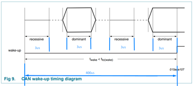

JozefKozon
Dear Ufuk,
the whole wake-up recessive-dominant-recessive-dominant sequence occurred on the CAN bus must be shorter, than the tto(wake) time.
At the same time, the recessive and dominant times must be minimally twake(busrec)min and twake(busdom)min respectively.
Its best if you take the tto(wake) minimum value, 400us and the twake(busrec)min and twake(busdom)min maximum values. For both 3us. Even in this case you have plenty of time to conduct the wake-up recessive-dominant-recessive-dominant sequence within the tto(wake)=400us. 4*3us=12us.
The times between the recessive and dominant pulses is not stated.

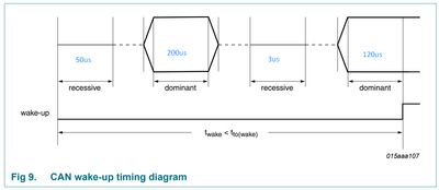

JozefKozon
Dear Ufuk,
you can disable the Bus wake-up detection with setting the STBCC bit to 0. If the STBCC is set to one, the recessive-dominant-recessive-dominant sequence will wake up the UJA1076. Yes, no message ID is required.
When the UJA1076 woke-up with a random CAN message, can you please check if the message didn't contain the recessive-dominant-recessive-dominant sequence?
For example:
Or any other timing, but the recessive-dominant-recessive-dominant sequence within the 400us.
With Best Regards,
Jozef

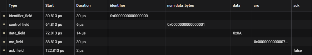

Dear @JozefKozon,
Firstly, Sorry for getting back to your reply late.
I have UJA1076A High-speed CAN core system basis chip. I'm not sure the wake up message was sent correctly.
I attached screenshot please check it.
3,709件の閲覧回数
JozefKozon
Dear Ufuk,
thank you for the scope. However this doesn't seem to be taken from the CANH and CANL differential pair pins. Is the signal taken from TXDC or RXDC pin? Could you please connect two probes on the CANH and CANL pins while the UJA1076A is in Sleep mode and please share a scope of pattern, which unwantedly woken-up the SBC?
The wake-up pattern doesn't need to contain the CAN ID, DATA, nor CRC value. Any pattern on the CANH and CANL pins will wake-up the SBC as long as it fulfills the CAN wake-up timing diagram in the Figure 9.

maximillion
Dear Jozef,
Signal received from TXDC I will share pattern of wake up for CANH and CANL as soon as possible.
I am using S32K148evb to send wake-up pattern message. I am not sure how to send can wake-up message without message ID or DATA. According to your information should I send only 0x0A
