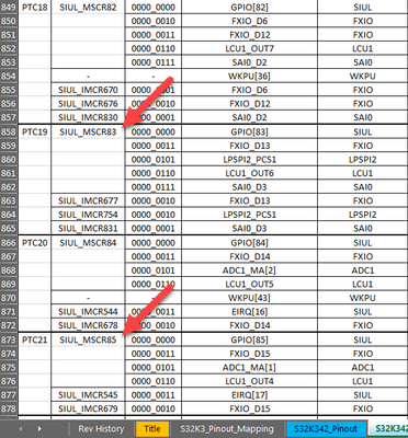

pratik_a
Hi @Julián_AragónM ,
I have finally worked out the way around to toggle the LED,
For anybody reading the post please follow the below link,
HOWTO: Create a Blinking LED application project for S32G using S32 RTD with AUTOSAR - NXP Community
1) Dio port ID is 5 for me and any Dio channel ID should work.
2) MSCIR 83 and 85 for PTC 19, and PTC 21 for S32k322.
Thank you for supporting.

Can someone please verify if I'm doing anything wrong?
Also, I'm unsure what "Dio channel ID" in Dio Configuration to use for PTC19 and PTC21 for the S32k322 microcontroller.

5,880 Views
Julián_AragónM
Hi @pratik_a,
It seems the declarations for the number identifier (MSCR) are off by 1. Please take a look into the IOMUX.xls for the values of each pin (83 & 85):
Please help me confirm if this change works, also make sure to have the pins declared in the Pins and Modules view of Config Tools (the same way as the example shows).
Julián
