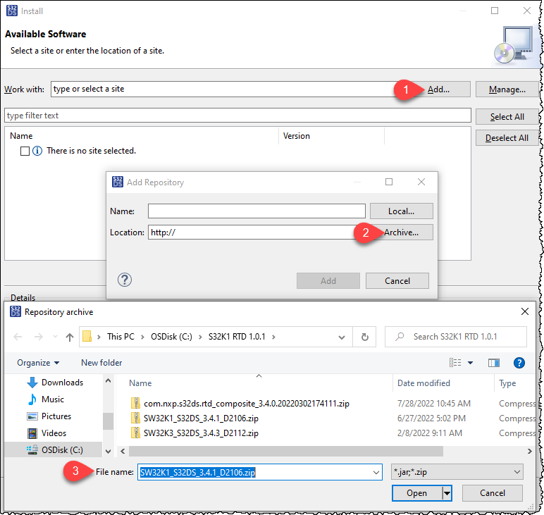

I am trying to install the S32SDK_S32K1xx_RTM_4.0.2 SDK extension through the S32 Design Studio IDE, but I am getting an error. Please help me install it.
Please refer to the attached screenshot. provide the solution ASAP.

It is recommended to install S32K1 RTD 2.0.x with S32DS Extensions and Updates in S32DS v3.5.  If the online installation fails, please refer to HOWTO: offline install S32K1 RTD 2.0.0 in S32DS v3.5
Or install S32K1 SDK RTM 4.0.3 with S32DS Extensions and Updates in S32DS v3.4.
It is not recommended to install S32K1 SDK 4.0.x in S32DS v3.5According to the currently available information, we don’t have any plan to integrate S32SDK S32K1XX 4.0.x into S32DS 3.5 or above version.

Trying to Install S32K1 SDK RTM 4.0.3 with S32DS Extensions and Updates in S32DS v3.4. But getting error

I'm afraid you need to offline install the S32K1xx development package:
Download S32 Design Studio 3.4 S32K1xx Service Pack 1 (SW32K1_S32DS_3.4.1_D2106.zip) at My NXP Account -> Software Licensing and Support -> Software accounts and add it as an updated site.

After you have installed SW32K1_S32DS_3.4.1_D2106.zip offline, you should be able to install S32SDK S32K1XX RTM 4.0.3 online via S32DS Extensions and Updates.
install S32SDK S32K1XX RTM 4.0.3 online via S32DS Extensions and Updates.png
