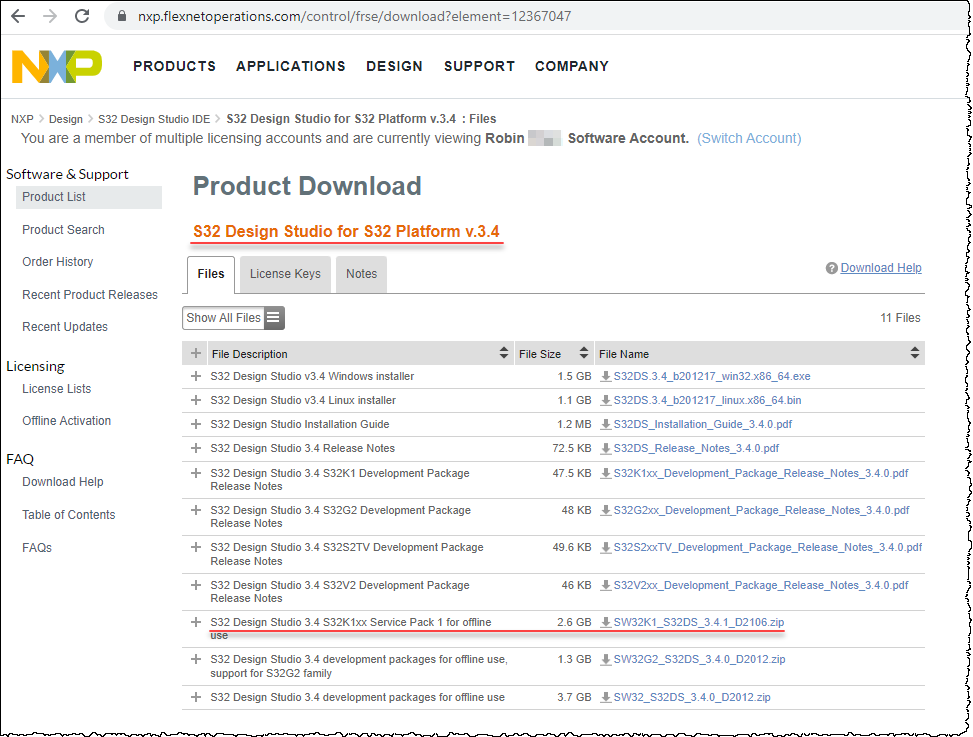

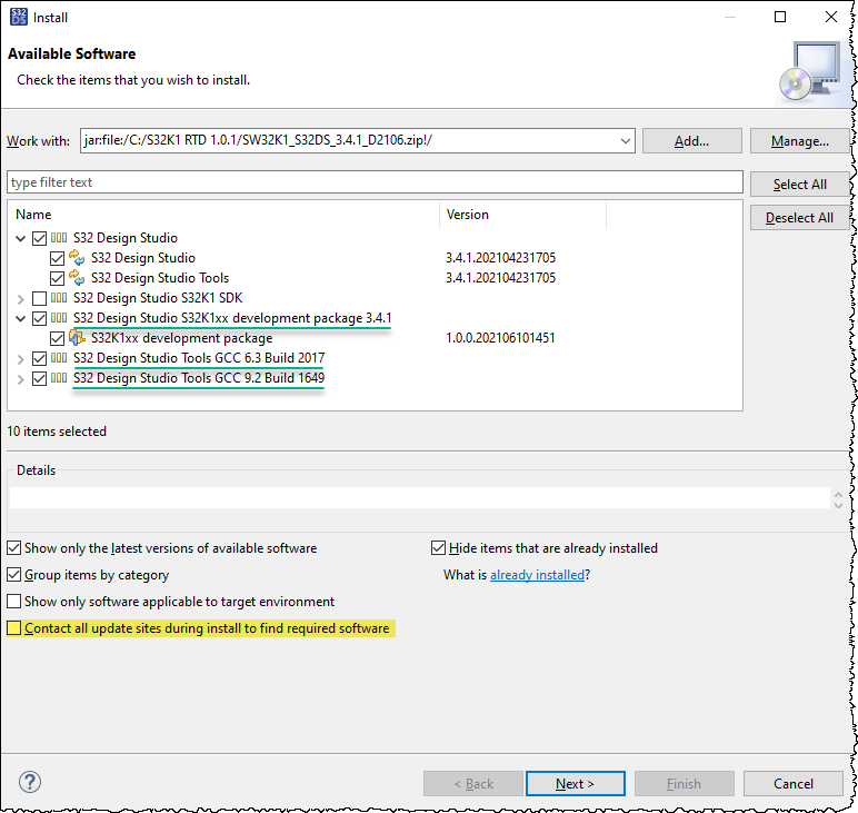

I'm afraid you need to offline install the S32K1xx development package:
Download S32 Design Studio 3.4 S32K1xx Service Pack 1 (SW32K1_S32DS_3.4.1_D2106.zip) at My NXP Account -> Software Licensing and Support -> Software accounts and add it as an updated site.

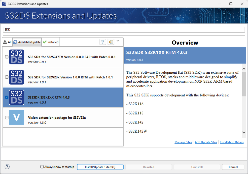

Robin_Shen
After you have installed SW32K1_S32DS_3.4.1_D2106.zip offline, you should be able to install S32SDK S32K1XX RTM 4.0.3 online via S32DS Extensions and Updates.
install S32SDK S32K1XX RTM 4.0.3 online via S32DS Extensions and Updates.png
