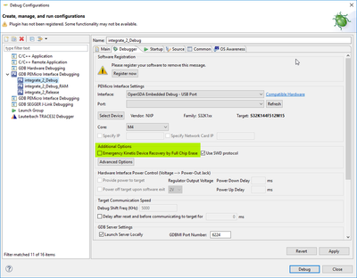

No error is showing on s32ds,inside debug configuration I checked Emergency Kinetic Device Recovery by Full Chip Erase' option and then clicked on flash but instead of doing mass erase, it took me to debug window.

Could you try selecting "Emergency Kinetis Device Recovery by Full Chip Erase" in debug configuration and sharing what message is returned? (Even if it's not an error message directly from the debugger)

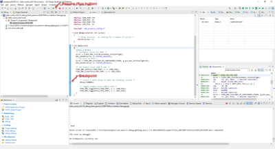

Sorry for the misunderstanding, but the last image you shared shows the Debug View for the project with the MCU connected.
Is the example not running correctly, or what is exactly the problem after doing a Full Chip Erase?

In  S32ds,I am unable to do full chip erase even after selecting emergency full chip erase option.
S32ds IDE is taking me to debugger console only.

The mass erase is performed prior to flashing your code. The debugger console as you've shared from the last image is the project running from the debug view.
Are you trying to only perform a mass erase without debugging or flashing the project?

As per your last image, the project has been built and is in debugger mode, which means the mass erase has been successfully completed, and the debugger identified your board, all left to do is to run the code from the green play icon.
Julián

I have just uploaded the example to the board and there was no issue.
Just as confirmation, when you debug and click Resume (F8), does the code keep running? Or does it stop? It seems you have a breakpoint in line 45 (delay(720000);),
If nothing happens after running the code, there may be some hardware problems in your board.
