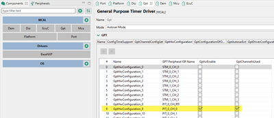

Julián_AragónM
Hi @pratik_a,
Please make sure the GptIsrEnable and GptChannelIsUsed options are enabled:
Define the Pit notification and the ISR handler is defined:
Julián

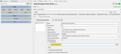

pratik_a
Hi @Julián_AragónM ,
I have been wanting to implement the Autosar method for timer functionality. As per the example provided, I have included the necessary components please refer to image 1.png
I want to generate an interrupt every 1 millisecond.
Can you also confirm if the callback function is equivalent to ISR implementation in the code? I want to specifically implement an ISR routine which will be called every 1 millisecond, and my state engine will change its state accordingly.
Pratik

Julián_AragónM
Hi @pratik_a,
It seems the components added to your project are okay, could this be an issue with the initialization of other modules apart from the GPT? Like the GPIO or the clocks? Could you confirm the example runs, and if the callback function is being stepped into?
An Interrupt Service Routine (ISR) is a function which runs when a hardware interrupt is triggered, the same way a Callback is a software implementation of this. An ISR needs to be installed with an interrupt vector (for example in the Siul2_Icu_Ip_BlinkLed_S32K344 example, SIUL_2_IRQn), and a Callback can be added into the interrupt routine.
You can modify the notification/callback function which will be modified by your state engine in this case.
Julián

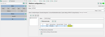

Julián_AragónM
Hi @pratik_a,
Julián
13,638件の閲覧回数
pratik_a
Hi @Julián_AragónM
It worked...Thanks for your continuous help.

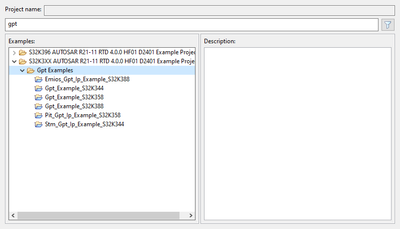

Julián_AragónM
Hi @pratik_a,
The RTD 4.0.0 package includes examples for the General Purpose Timer:
After the initialization the channel will start counting, the notification will be generated and a 'while(1) loop' will run to blink a LED. You can use these examples as reference and modify the counter to change the period.
Julián

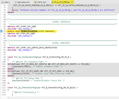

Also, can you guide me to where the void Gpt_PitNotification(void) function is declared? I just want to confirm if it is timer interrupt callback function?
13,794件の閲覧回数

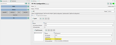

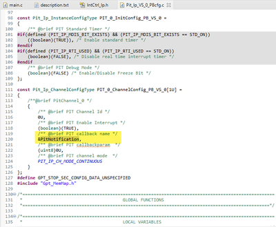

Julián_AragónM
Hi @pratik_a,
PitNotification should be declared in the pit configuration file. It is indeed a callback function:
Julin_AragnM_0-1709847853749.pngJulin_AragnM_0-1709847853749.pngJulin_AragnM_1-1709847860049.pngJulin_AragnM_1-1709847860049.pngJulin_AragnM_2-1709847867425.pngJulin_AragnM_2-1709847867425.png
Just to confirm, when debugging does the code step into the Gpt_PitNotification function?
