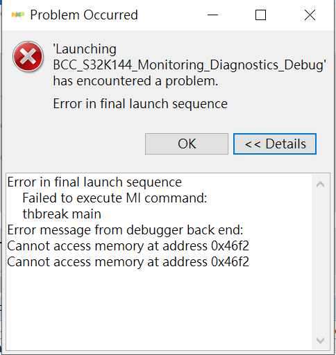

hsieh_jaros
Hi Sir
According to the operating information follow:
HOWTO: Change the CPU Derivative in an SDK-Based Application Project
I was changing the MCU from S32K144 to S32K142 and build code successfully
but it's has a Error Signal when the image was flash into MCU
How to resolve the bug ?
Help us ,Please.
Thank you very much.

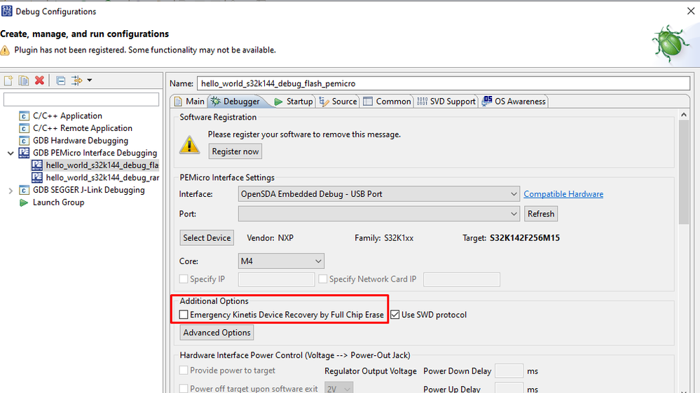

dianabatrlova
Hi Jaros,
It is not easy to find out the root cause of this error.
However, after discussion with S32DS experts, the emergency Kinetis device recovery option in debug configuration can help.
Also, you can try to delete all breakpoints, clean project, rebuild and try to debug again.
If not help, can you share your project?
