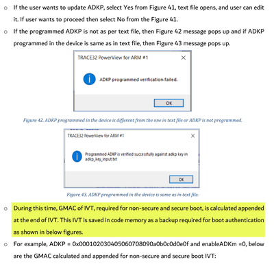

I'm studying the HSE_Demo code from S32K3XX_0.2.1 . When programming ADKP service, I noticed that the function generateIvtSign() is executed.
I would like to ask about the purpose of this function

Hi @Jack_Hsu
it's mentioned in the readme file:
c:\NXP\HSE_DEMOAPP_S32K3XX_0_2_1_0\HSE_DEMOAPP_S32K3XX_0_2_1_0_ReadMe.pdf
Lukas
