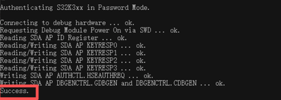

liTian_one
Yes, I have program a password and advance the MCU lifecycle, and using HSE.
I followed the method you provided and performed the PE unlocking operation, and it was successful as indicated.
However, after that, when I was debugging, the problem still persisted.
Is it the case that "secure boot" and "secure debug" cannot coexist simultaneously?
When secure boot fails, the secure debug cannot maintain the unlocked state?

VaneB
Hi @liTian_one
Secure boot and secure debug are indeed designed to coexist. As long as the ADK/P (Application Debug Key / Password) is known and debug access is enabled, it is possible to recover the device in the event of a secure boot failure.
If an SMR verification fails during any boot phase—whether pre-boot or post-boot—one of two types of sanctions may be applied. Based on the applicable sanction, the HSE firmware will enter its default recovery mode.
In cases where the device enters JTAG-Based Recovery Mode, the HSE remains in a reset state. This reset condition also clears any active authentication.

VaneB
Hi @liTian_one
Yes, every time a reset or power cycle occurs, the authentication is cleared, and the device returns to its locked state.
This is also why it is necessary to select the "SECUREDEBUG" version of the device in your debug configuration (e.g., "S32K344-SECUREDEBUG" instead of "S32K344"). This selection ensures proper handling during debug entry, especially since a reset is triggered as part of the debug initialization process.

VaneB
Hi @liTian_one
If the HSE firmware authentication fails during the secure boot process, it may affect any prior authentication done by the debugger. However, you can still reconnect the debugger to recover the device.
In case of a secure boot failure, the SBAF will first attempt Secure Recovery Mode. If that fails, it will switch to JTAG-Based Recovery Mode, where the device waits for a debugger connection to allow recovery.
