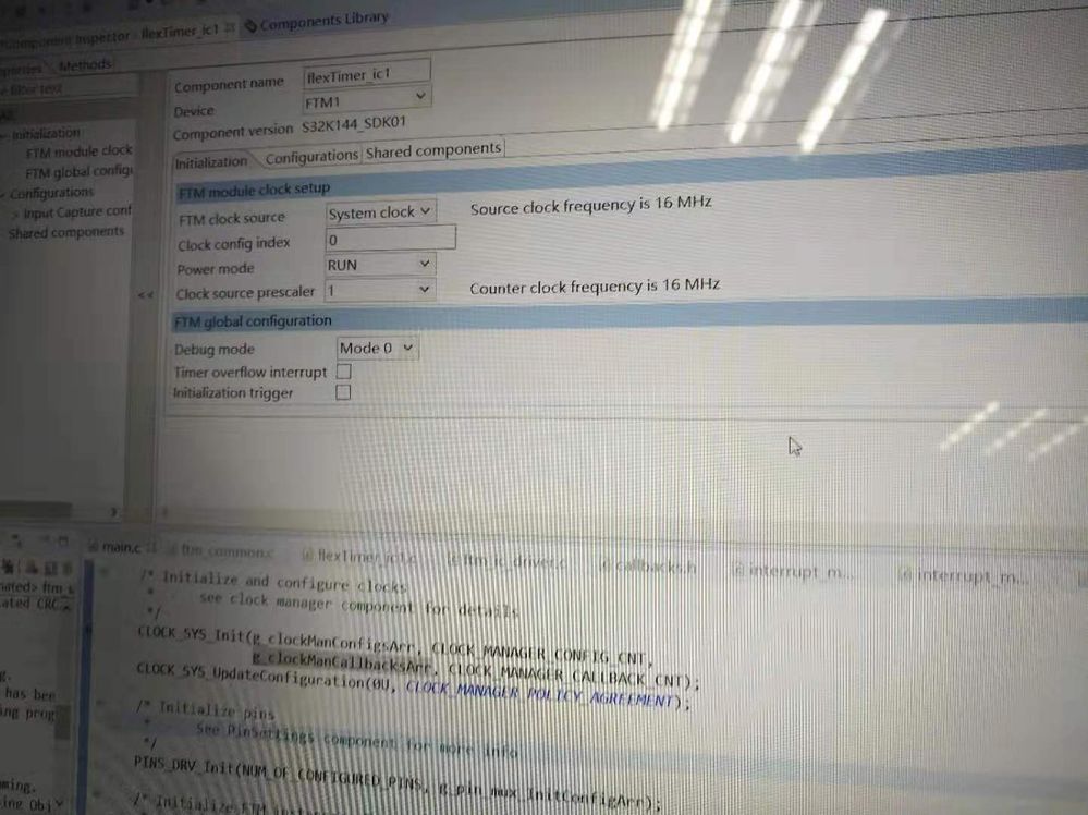

counter clock frequency is 16Mhz,
It can be captured normally at high frequency,but the counter will overflow at low frequency.
as shown below, the left side is the generated frequency and the right side is the frequency at which the input is captured.

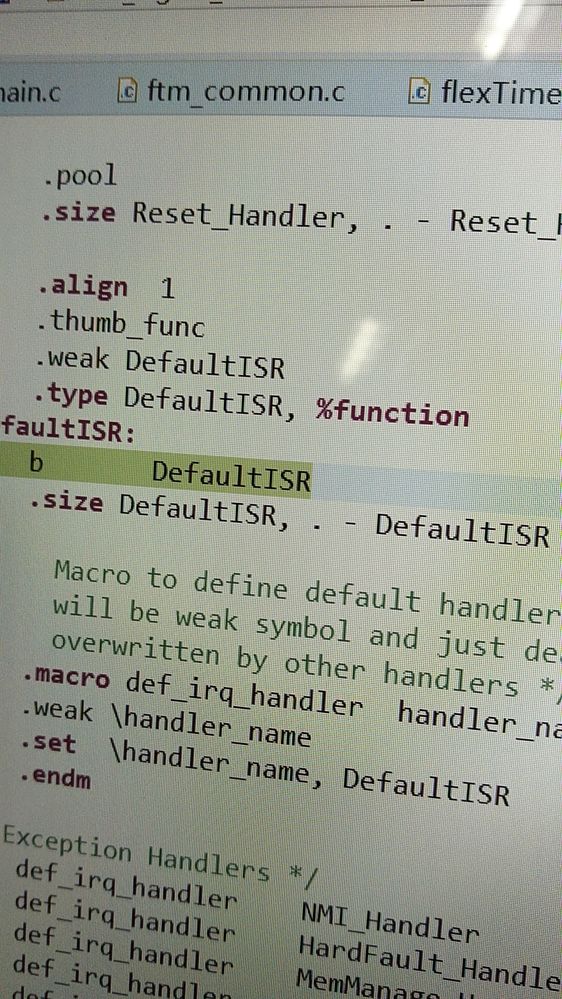

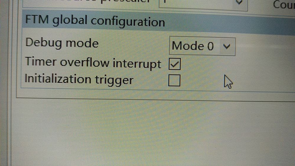

Then initialized the counter overflow interrupt , but the program does not work properly.

/*Enable counter overflow interrupt, when counter overflow, do accumulation.

//Enable counter overflow interrupt
 INT_SYS_InstallHandler(FTM1_Ovf_Reload_IRQn, &FTM1_IC_ISR, (isr_t *)0);
 INT_SYS_SetPriority(FTM1_Ovf_Reload_IRQn,6);
 INT_SYS_SetPriority(FTM1_Ch0_Ch1_IRQn,6);
