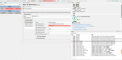

1. When using the fee module to set 0x10002000 as the starting address, the S32DS compiler reports an error. Can you help solve this issue?

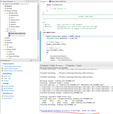

I don't see any compiler error

The MEM_43_INFLS and MemAcc of MCAL will report errors, as shown in Figures 1 and 2.

I didn't see any error on myside, maybe you can click "update code" to see if the error will miss or not.

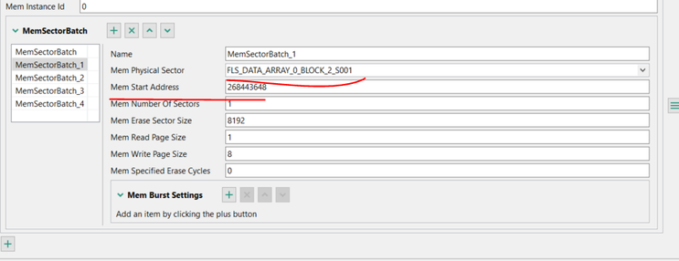

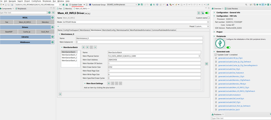

After clicking the "Update" button, please check the error displayed in the lower right corner of the image. The MemSectorBatch address can only be set to 0x10000000 and cannot be set to 0x10002000.

You should know that “Mem Physical Sector” and “Mem Start Address” are one-to-one and fixed, and cannot be modified.

I want to ask, is this the code you wrote yourself?
Have you confirmed that the RTD version is consistent with the project you provided?
I have already shown you my screenshots, and there is no ERROWs.

3. I saw your screenshot; setting the starting address of MemSectorBatch to 0x10000000 is fine, but when I try to set MemSectorBatch to 0x10002000, I get an error.
4. I want to use 32k of data flash starting from 0x10002000, and reserve the data flash from 0x10000000 to 0x10001FFF for booting purposes.
