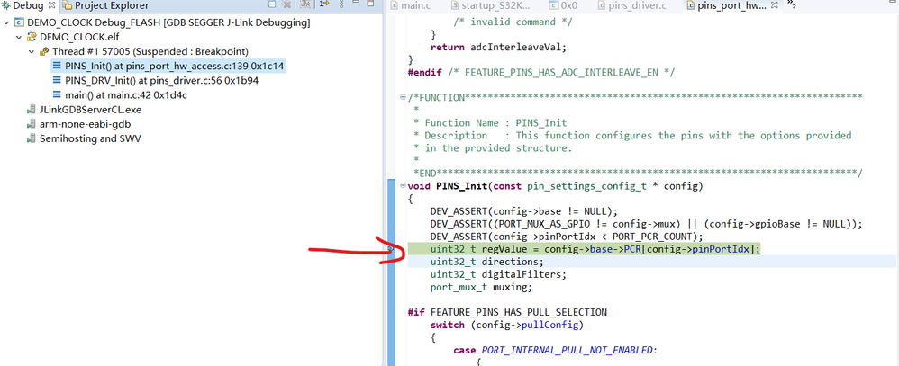

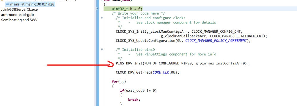

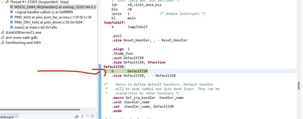

The S32K144 is configured to 80MHz in RUN mode and initializes the I/O port into the Hard Fault
2,597 Views
JingchunChen
 IN S32 Design Studio for S32 Platform 3.4 ,SDK is S32 SDK RTM 4.0.2 for S32K144:M4F;
RUN MODE 80MHzRUN MODE 80MHzExample Initializing the I/O portExample Initializing the I/O port屏幕截图 2023-04-14 100831.png屏幕截图 2023-04-14 101907.png
What's the problem, please

Hi@JingchunChen
I have reproduced your problem, please try to install S32SDK_S32K1xx_RTM_4.0.3,I have tested this version without such problems.

JingchunChen
原因是在4.0.2版本在时钟配置HRUN模式时有错误,但在RUN模式下生成代码没有错误或警告提示,导致编译完成发生错误。将HRUN模式错误消除就可以了。

zmikeska
I am facing the same issues with SDK ending in "DefaultISR error". I am using S32K144 48pins and S32 DS for 32 platform. Actual SDK is 4.0.1. No SDK 4.0.3 is existing. I have not found any solution of this problem anywhere. Btw. even the example project is not running correctly.
