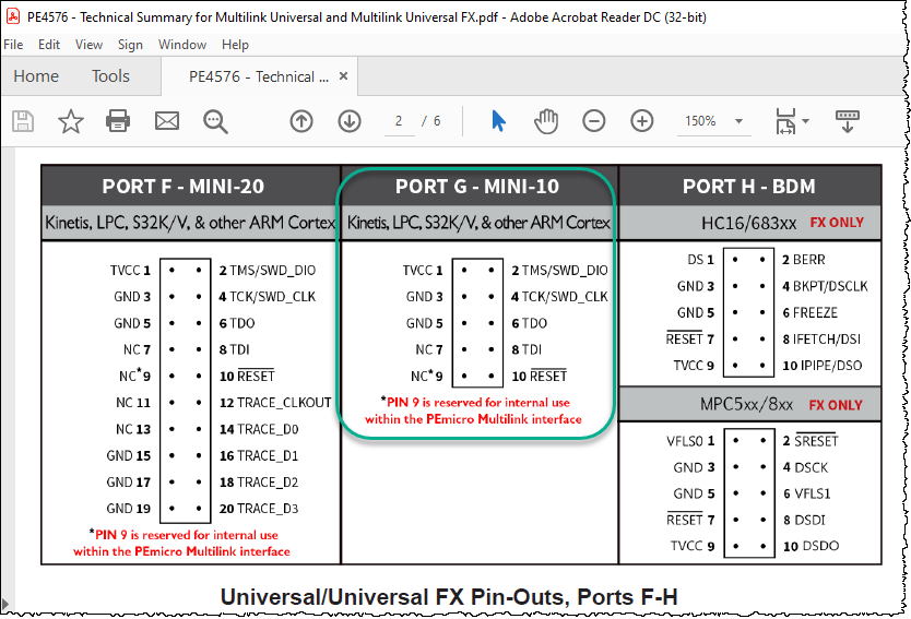

PEmicro GDB Launch Failure : The GDB Server was not able to establish a connection to the target processor. Please check your connections and power. Verify that the launch settings in the Debug Configuration are accurate.
i use my own pcb,
S32 Design Studio for ARM Version: 2018.R1    Build id: 180815
chip:S32K116.

Hi xinyu1650,
Have you check the connections and power?
Have you successfully program the chip before?
Please observe the waveform of the RESET pin with an oscilloscope and upload a picture. If there is a periodic pulse, please let me know the period of the pulse.
Have you tried to using P&E Recovery Utility halt MCU by refer to: https://community.nxp.com/t5/S32K/Can-t-use-PEmicro-debugger-with-S32K118EVB2-Q048/td-p/1376204

xinyu1650
No change in pin voltage(reset  and vcc  pin),the voltage is 0v.
7,147件の閲覧回数
Robin_Shen
Would you please power the S32K116?
