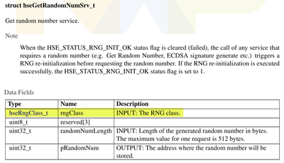

HI ,

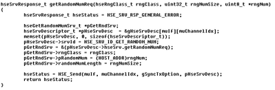

   I am looking for more information regarding the class of the TRNG but i am not able to find any document. I need detailed information regarding the class like DRG3 , DRG4 for TRNG so that i can know which one i have to use for the CMAC key generation.
Kindly provide me the document.

lukaszadrapa
Hi @vikmonti7804
search for rngClass keyword in both HSE-B Firmware Reference Manual and also in S32K312_HSE_Service_API_Reference_Manual which can be found in HSE FW package.
Lukas

vikmonti7804
Hi Lucas,
            I am trying to generate the Random number generation but its not working and giving back the response that the feature is not supported (HSE_SRV_RSP_NOT_SUPPORTED).
23,879件の閲覧回数
lukaszadrapa
This is caused by data cache, most likely. To confirm it, you can simply turn off the data cache and it should work. To solve it, all the data structures used for communication with HSE via MU need to be forced to non-cacheable memory.

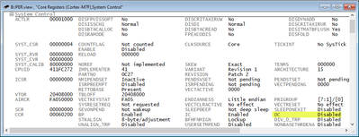

vikmonti7804
HI Lucas,
           Can you please explain how to turn off this data cache?
And how to do all the data structures used for communication with HSE via MU need to be forced to non-cacheable memory ?
please explain with some images.
23,836件の閲覧回数
lukaszadrapa
Data cache can be disabled by DC bit in CCR ARM core register:
https://developer.arm.com/documentation/dui0646/b/Bhcjabhi

lukaszadrapa
Hi @vikmonti7804
I tried to turn off the data cache as a first step:
And I can see that the random number is generated:
So, this confirms it's caused by the cache. I can see that you only copied the definitions from the example. But this does not solve the problem. If you take a look at the function:
... there are local variables used for communication with the HSE via MU and the stack is obviously cacheable because it does not work.

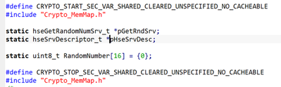

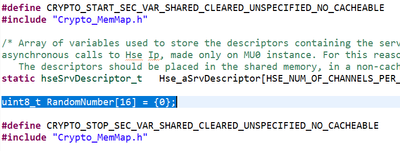

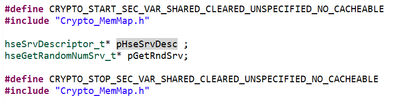

lukaszadrapa
I have some troubles to open the project and I can't spend so much time with this. But what I would try:
There are following variables in GetRngNum() used as inputs for HSE: pHseSrvDesc and pGetRndSrv.
To force them to no-cacheable area, you can define them as global variables and use:
#define CRYPTO_43_HSE_START_SEC_VAR_SHARED_CLEARED_UNSPECIFIED_NO_CACHEABLE
See the example in RTD which shows how to do that exactly:
And then do the same for RandomNumber array in main.c file.
Lukas

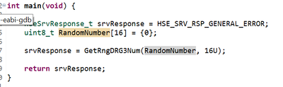

vikmonti7804
Hi Lucas,
        what is the problem you are getting to open this project? Please let me know?
I tried in main and rng.c file but still its not working. please share at least the main file after modification if possible
and i tried in rng.c file

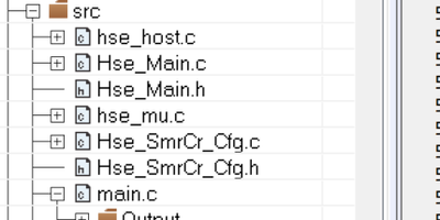

Hi Lucas , thank you for your support.
i have used the crypto example code for s32k312 from rtd 4.4 2.0.3 and added all the folder services, interface, drivers and framework and trying to use this project for development purpose, but i am stuck in some hardfault and i am not able to resolve.
kindly help and find the attached project.
loges are beow.

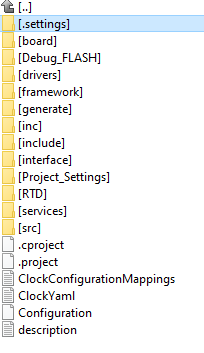

vikmonti7804
Hi Lucas,
             Before adding these folders services, framework, interface and drivers to the project, the mcal configuration was having no errors but after adding these folders to the projects the mcal configuration is having the errors. please find the attached image. kindly help for hard fault. you can this project i have already attached in previous message.
 If possible provide some time or invite to discuss, can be half an hour call, i need to clarify many things.
24,020件の閲覧回数

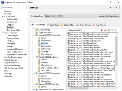

lukaszadrapa
A couple of things:
- the error "Processor..." was caused by missing .settings folder. I added the folder from another project and the problem disappeared.
- then there were some issues with paths. Not sure why but I fixed it using "workspace" paths like this:
- and the hard fault was caused by linker file:
There's only 96KB RAM, so it ends at 0x20417FFF.
Lukas
