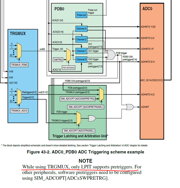

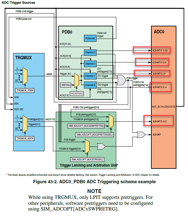

Hi@Sriram
I am not familiar with MBDT. If you have any questions about MBDT, please be sure to create a new topic and add MBDT related keywords.
You can see the difference in the red highlight.
1. Each PDB module has 4 channels, and each channel can support 8 pre-trigger channels, which can realize pre-triggering of a total of 32 channels of the ADC module.
2.PDB module supports ADC_COCO
3. If TRGMUX is used to achieve pre-triggering of the ADC channel, it can only be achieved through the LPIT module, and: LPIT doesn’t support ADC_COCO feedback, it needs software to correctly control the ADC trigger timing setting.
4.Software pre-trigger,SIM_ADCOPT[ADCxSWPRETRG].
The summary is that PDB perfectly supports ADC and is specially designed for the ADC module.
This is what I can explain, for more details you need to read the data sheet yourself

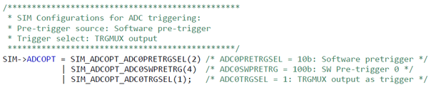

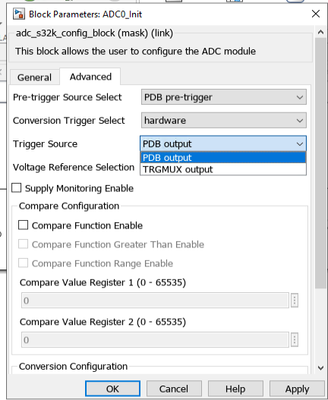

Hello @Senlent ,
Thank you for your quick reply. I have attached few pics from the matlab model,
First 2 pics are from the PDB Init dialog box. In adc0 im using 5 channels and they are triggered by trigmux_pdb_trig. All 5 channels seems to be working fine when i trigger it with trigmux
The pic below is the ADC init dialog box. In the pre trigger source, there are 3 options - PDB , TRGMUX and SOFTWARE . What is the difference between the PDB trigger and TRGMUX
Thank u

Senlent
Hi@Sriram
Here, you are setting a software pre-trigger, so there will be no such limitation.
If it is hardware pre-trigger is implemented through TRGMUX, then you can only use LPIT, and only SC1A to D can be used.
