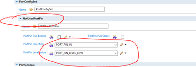

- For Pins that you don't configure and want to set them in a default mode, you can consider NotUsedPortPin configuration:
Unused pins will be set in GPIO mode and the direction will depend on the above configuration

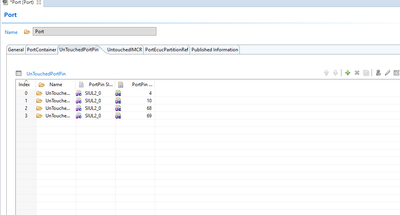

- For pins that you don't want driver to touch them, add them in the UnTouchedPortPin:
Nam

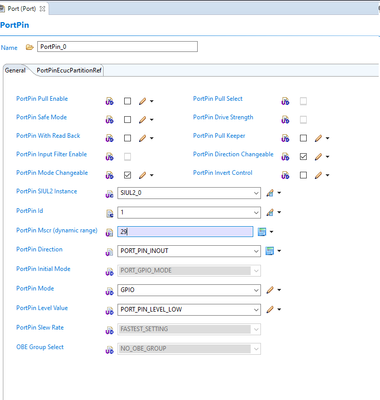

Vijay_Arwapally
Is there a way to make port and dio and other configuration easy?
To configure PTA29, below is configuration and someone reviewing it later will be finding it hard to read as it requires cross verifying Mscr value to IO_Mux.xlx:
Is there a symbolic way to do this instead?

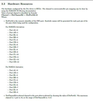

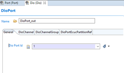

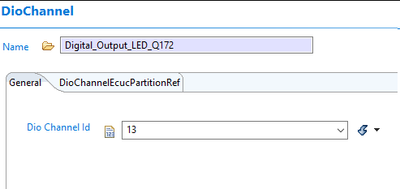

Similar is the problem with DIO channel, where-in it requires calculation for portH and port L and then 16 bits to arrive at the dio channel value:
Below is the formula to arrive at DIO channel value, which seems to tedious:

- With Dio, it's the AUTOSAR compliant that we need to follow.
