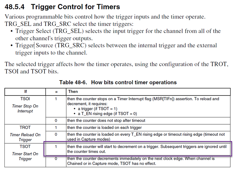

Hi NXP,
 I want to start timer of LPIT CH 1 after fixed time(fixed clock cycle to timer ) from the moment when LPIT CH0 start.
Suppose I started CH0 timer and the moment when it real timer value reach 10000, i need to start CH1.
How can achieve this.???
1 返信
801件の閲覧回数
danielmartynek
Hi @KKumar,
LPIT Ch0 can trigger Ch1.
Please refer to the description in the RM.
You need to select the internal 0 trigger (TRG_SEL, TRG_SRC) and configure TSOT.
