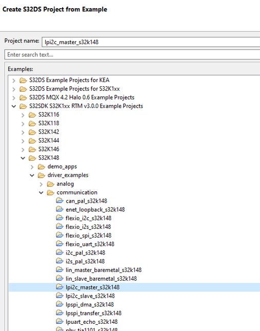

Hello @saireddy_saredd,
Please use the SDK drivers either in S32DS 2.2 or S32DS 3.4.
There is this lpi2c_master_s32k148 example
For example, In S32DS 2.2, set the address of SE050 in Process Expert Component Inspector.
