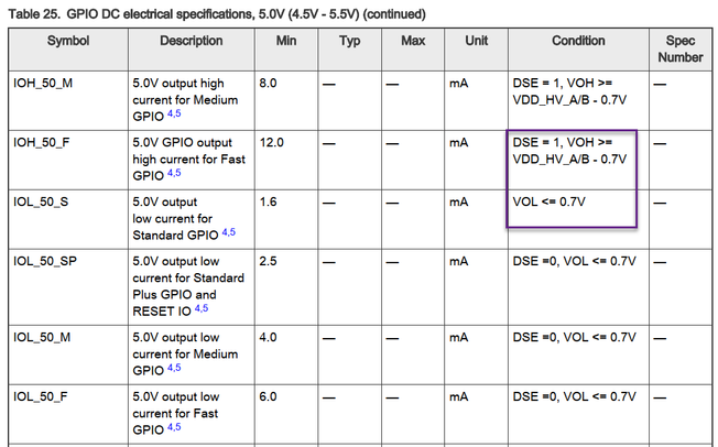

Hi NXP Team,
What is the maximum current that can sink to a GPIO pin/ maximum current that the GPIO pin can source in S32K3xx microcontrollers?
1 返信
807件の閲覧回数
danielmartynek
Hello @hemanths,
The higher the current the bigger the voltage drop from VDD/VSS.
The datasheet specifies the min. guaranteed current at
VOL <= 0.7V
VOH >= VDD_HV_A/B - 0.7V
for all the GPIO types.
Refer to the IBIS model of the device for more information.
