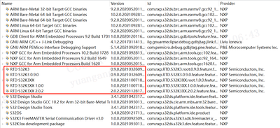

1. What's the difference between "Installation details" and "Extensions and Updates"?
2. I have already uninstalled RTD 2.0.2 in "Extensions and Updates", why RTD 2.0.2 still shows in "Installation details"? Is there any difference?

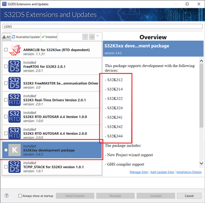

When you select the package in the S32DS Extensions and Updates feature, the Overview panel will detail which devices are supported by the package.
S32K3xx development package example:

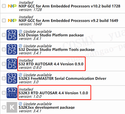

S32K3 RTD AUTOSAR 4.4 package example:
