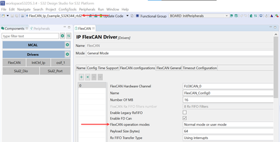

coo
@VaneB
I found the cause of the problem.
The example is in loopback mode, but is there another example in usermode? I would like to see actual data communicated by pcan-view.
thanks.

1,946 Views
VaneB
Hi @coo
Yes, the example code provided with the RTDs is in loopback mode, but the link shared before is an example code configured in normal mode or user mode. check the attached images for reference.
