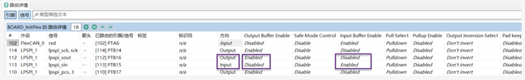

        While troubleshooting the SPI configuration, I discovered that the input and output interfaces of the UJA1169's SPI were mistakenly cross-connected with those of the SPI1 on my S32K312 board, resulting in an inverted connection.
        Therefore, as stated in the Reference Manual, I attempted to configure Sin as the output interface and Sout as the input interface by adjusting the CFGR1[PINCFG] setting. However, after completing the configuration, I found that normal communication was still not possible.
        May I inquire if it's feasible to reverse the roles of SPI1's Sin and Sout interfaces? And if so, are there any additional configuration considerations or precautions I should be aware of?
        My SPI configuration is as shown in the attached file. By the way, the CLK (Clock) and CS (Chip Select) signal waveforms are normal.

Hi @azure,
If PINCFG = 0x3, SIN is the output whereas SOUT is the input.
You need to change the configuration of the pins, output and input buffers.

azure
        Thank you for your assistance.
        Currently, SPI communication between the S32K312 and the UJA1169 is functioning properly. However, I've encountered a new issue. I'm attempting to put the UJA1169 into sleep mode by first sending SLPC = 0, followed by MC = Sleep. Yet, regardless of the data I send, the UJA1169 simply echoes back the same data and does not enter sleep mode. For instance, using the Lpspi_Ip_SyncTransmit() function, I send a two-byte array where the first element is the register address (0x74 << 1) and the second element is the specific value 0, but the UJA1169 merely returns the identical values. Is this echoing behavior from the UJA1169 normal? Are there any critical points that I might have overlooked?
