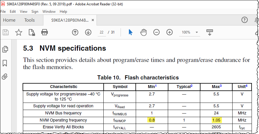

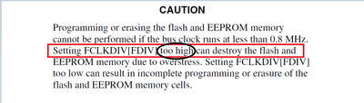

Can we use FDIV = 0x13 value? Because in the reference manual, there is one NOTE which tells not to use maximum value. Which value we are considering too High  = 0x13 or FDIV[5:0] 2^6 = 64?
So is it safe to use FLASH for 20MHz?

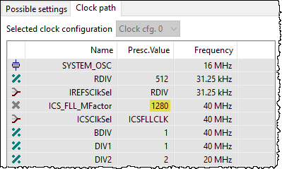

Hi Sourdev,
If you are using FRDM-KEAZ64Q64(S9KEAZ64AMLH), please note that you should read KEA128RM and S9KEA128P80M48SF0.
Notice: In FEE mode, FLL output frequency = OSC/RDIV *1280.
For that NOTE, configure FTMRE_FCLKDIV[FDIV] between fNVMOP.
You can set Core clock = 40Mhz and Bus/FLASH clock = 20MHz.

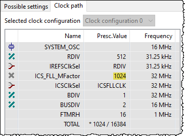

 I am using S9KEAZN64AMLC.
In that FLL Output = (OSC/RDIV)*1024
given in (reference manual KEA64RM)

If you have to use 16MHz crystal as clock source with FEE mode, then the frequency of the Core clock will be 32MHz, and the frequency of the Bus\Flash clock will be 16MHz.
S9KEAZN64AMLC 16MHz crystal 32MHz Core.pngS9KEAZN64AMLC 16MHz crystal 32MHz Core.png
For 40MHz Core clock and 20MHz Bus\Flash clock, you may need to use 10MHz crystal with FEE.
