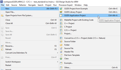

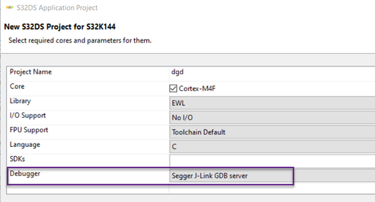

When you create a new project, you need to select Segger J-link GBD server as the debugger.

I did not get any option related to Segger jlink in debbuger while creating new project
I am getting only PE and s32 debugger here.

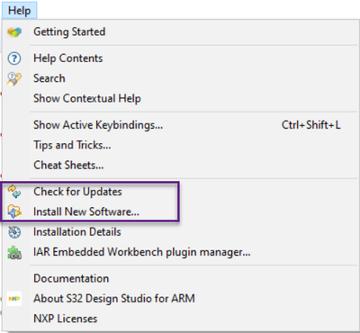

You can check for updates / new SW.
But I would recommend using a newer version of the Design Studio.

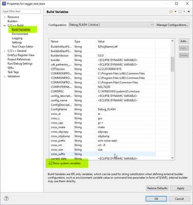

Did you created your project as a S32DS application project?
With this option all paths should be configured correctly for new project. You can check it in project properties:
