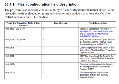

moogambika
hi @Julián_AragónM ,
Thanks for the response.
We currently have the Bootloader in DFlash and Csec disabled.
Q's:
1.Do we need to enable Csec if Backdoor Key need to be used ?
2.Where will it be stored?
3.How it is related to Security setting and Mass erase setting?
Moogambika.
281 Views
Julián_AragónM
Hi @moogambika,
1. No. You can refer to this community example: Example S32K144 Verify Backdoor Access Key S32DS1.3 - NXP Community.
2. Inside the FTFC module:
3. I don't understand this question. When S32K144 MCU is secured (SEC bits != 0b10), it can be unsecure using either Mass Erase or Verify Backdoor Access Key command, if they are enabled.
FTFC module contains the flash protection and system security settings. Please refer to chapter 36 from the S32K1 reference manual, and related application notes: AN5401, AN12130, AN11983.
