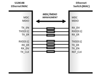

Dear Team,
I have an ethernet MAC TO MAC connection between SAMA5D27 and S32K148.
Schematic is attached here.
May I know your comments.

for RMII MAC-to-MAC below connection should be done
So the one you have seems to be fine, only:
- S32K148 RMII_TX_CLK is the input
- if RX_ER not used should be tied low
BR, Petr

RX_ER of the both IC's should be connected to GND.
Please correct me if I am wrong

In my schematic TX CLK is coming from S32K and is going to SAMA5D2
