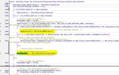

We use FS2600 with S32K3 on our design, SDK ver 4.0.0. and S32DS ver 3.5 Build id: 240726, update 13. FreeRTOS is used as OS.
During initialisation , this code is called:
Std_ReturnType initFs26Driver()
    Std_ReturnType retVal       = E_NOT_OK;
    /* Initializes the FS26 driver */
	retVal = Sbc_fs26_Init(&Sbc_fs26_xConfig_BOARD_InitPeripherals);
    if (retVal != E_OK)
        return retVal;
    /* Configures the device */
    retVal |= Sbc_fs26_InitDevice();
    if (retVal != E_OK)
        return retVal;
    /* Fault Error Counter should decrease to zero */
    uint8 u8FaultErrorCounterValue = 0U;
    retVal |= Sbc_fs26_GetFaultErrorCounterValue(&u8FaultErrorCounterValue);
    if ((retVal != E_OK) || (u8FaultErrorCounterValue != 0U))
        return retVal;
    /* Sbc device should be in FS_STATES_FS0B_ASSERT */
    Sbc_fs26_RxFrameType rxData = {0};
    retVal |= Sbc_fs26_ReadRegister(TRUE, SBC_FS26_FS_STATES_ADDR, &rxData);
	if((retVal != E_OK) || ((rxData.u16ReadData & SBC_FS26_FS_FS_STATES_MASK) != SBC_FS26_FS_FS_STATES_FS0B_ASSERT))
		return retVal;
    return E_OK;
Function Fails on Sbc_fs26_InitDevice(); specifically on Sbc_fs26_WaitInitFSClosed() -> Sbc_fs26_WaitInitFSClosed().
InitFS is not closed and the Sbc_fs26_GetDeviceState return FS_STATES_INIT_FS, as shown in image DeviceStateisInitFs.JPG.
attached the used configuration. can you please tell me why is this failing ?

During INIT phase you need refresh WD to decrease fault error counter into zero then close it,can you please verify your WD feeding wrong or correct?
3,092 Views
Kazarian
Hello @guoweisun
im using the RTD APIs, the function from the RTD : Sbc_fs26_InitDevice();  already implement the logic you mentioned, however the
/* Close initialization phase by sending first watchdog refresh. */
eReturnValue = Sbc_fs26_WdRefresh();
is not called, and the Sbc_fs26_WaitInitFSClosed(); return a status error 0x1. could it be a wrong config ?
3,046 Views
guoweisun
I am not software engineer here I only support FS26,for the FS26 enter into normal mode steps please see below picture,you can match the drive step by step to verify whether it works or not.
