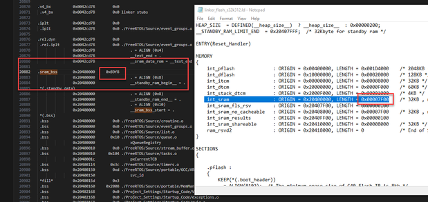

 we are developing project based on FreeRTOS sample code, now we got SRAM size issue. I queryed SRAM size 96KB of s32k312 from reference manual, but I don't understatnd why it has bss 43484 size, and add 8k SRAM size will generate overflowed, please help us, thanks

Could you recommand how many size can adjust from int_sram_no_cacheable  to int_sram size for safety?
May I adjust 16KB(int_sram_no_cacheable) to  int_sram 48KB(int_sram)?

thanks for your helping. May I adjust int_sram_no_cacheable size smaller about linker script?
and increasing int_sram size. Is it ok?

yes, this can be done,

This error is very clear, "sram_bss" section is located in the "int_sram",
The size of sram_bss occupied by your program is 0x89f8, which has exceeded the length of the int_sram space you defined.
