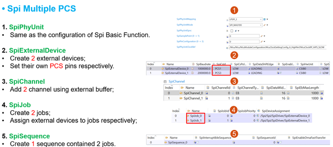

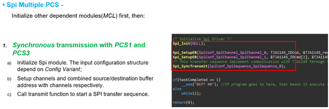

If that's the case, I've thought of two methods:
1.First
2.Second.

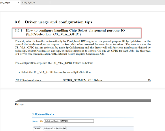

Please refer to the document: User Manual for S32K3_S32M27x SPI Driver

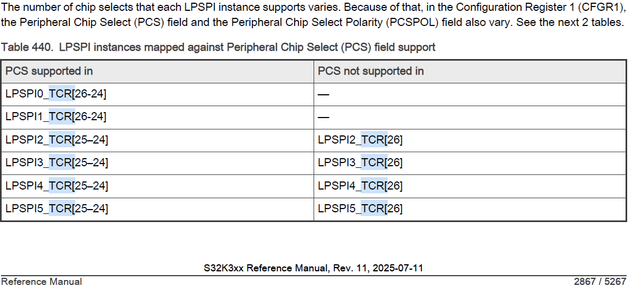

I need to write in this register TCR bit 26:24 but when i tried writing  it the SW raised exception handler, Could you please explain this behavior ?

There are some considerations when operating this register.
1.
2.
So which instance are you using? What is the PCS value being written? Did you operate on any unsupported PCS bits?

I'm using LSPI0 and PCS[0], I'm not setting in CFGR11[PCSCFG] : 1

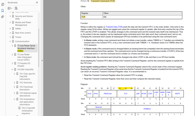

Hi@hafifi
Also, please double check this limited.
70.3.2.1Transmit and command FIFO commands
You must initialize Transmit Command (TCR) before enabling LPSPI in Peripheral mode, although this register is not updated until after LPSPI is enabled. After LPSPI is enabled, you must make changes to this register only when LPSPI is idle. In Peripheral mode, the LPSPI command word in this register controls SPI attributes. Before the PCS input asserts, the transmit FIFO must be filled with transmit data, or the transmit error flag sets.

Hi Senlent,
I have tried to writing in the TCR register PCS bit after SPI initialization, because to make sure after writing to avoid any over writing happen on it again but the same behavior.
Can we do that in EB tresos instead of write on it in runtime  ?
