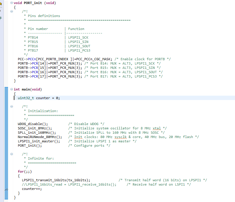

Hallo, I am a new user to S32k1xx series of MCU and working on my master thesis. I`m having some trouble interfacing an RF Chip to my µc. Once my API is executed, it is reported as hardware fault, and i cant identify the mistake. I want to just check if the SCK is active and MOSI is sending the data. Can someone please give me some guidance, i am not able to find support for this project, as S32k1xx is fairly new to some developers i know.

seems you did not enable clock properly for PORTC. So change a line
PCC-> PCCn[PCC_PORTD_INDEX] = PCC_PCCn_CGC_MASK; /* Enable clock to PORT D */
with
PCC-> PCCn[PCC_PORTD_INDEX] |= PCC_PCCn_CGC_MASK; /* Enable clock to PORT D */
PCC-> PCCn[PCC_PORTC_INDEX] |= PCC_PCCn_CGC_MASK; /* Enable clock to PORT C */
then it passes port init and you should see signal on SPI output.

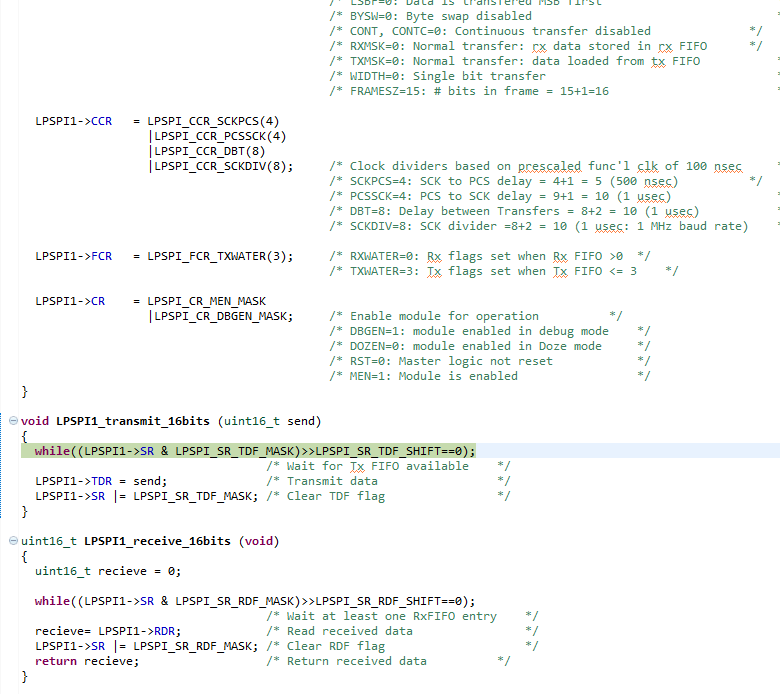

Thanks for checking. But now there seems to be a problem. I saw the output in my DSO a few days ago. But now its not working again. I even put the data tranmsit function on the for loop and it worked, but now the execution stops at the check TX fifo loop, what is even more strange is i tried the same for the example LPSPI program(non-processor expert) and the same problem. Changing the non stall bit on CFGR1 helped me last time. I don't understand this, is it the problem from hardware side. I did not made a changes on the example LPSPI, just removed the recieved function in void main, still the execution halts at the while loop as shown in picture. Kindly help me understand why.
