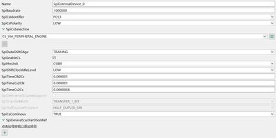

Hello, here is my SPI configuration. I can send twenty data in one CS, but i can't send three data in one CS, why?
I try to modify SpiEbMaxLength to three, but can't send out data.

Hi @Alex_min
For better support, could you please specify which MCU, IDE and SDK you are using?

Alex_min
S32K144 in the S32 Design Studio for S32 Platform 3.5. Use the S32K1 RTD AUTOSAR 4.4 Version   1.0.1 package.@VaneB

VaneB
Could you please check if any status register flag is set?
Also, have you tried assigning a value greater or less than 3 (ex.4,1) in SpiEbMaxLength?
