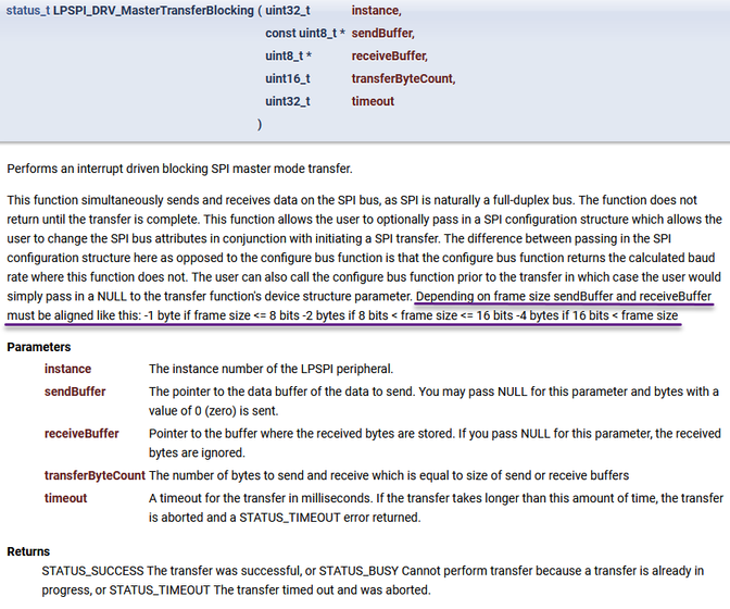

Hi Experts,
I am trying to implements SPI communication with my Slave IC with the option 32bits per frame.
But in processor expert generated code i can pass only 8bit char array:
status_t LPSPI_DRV_MasterTransferBlocking(uint32_t instance,
const uint8_t * sendBuffer,
uint8_t * receiveBuffer,
uint16_t transferByteCount,
uint32_t timeout);
Please suggest/guide how can i use processor expert with 32bits/frame.
1,231 Views
danielmartynek
Hi @Learner,
The frame size is configurable in the PE:
The buffers just have to be aligned:
