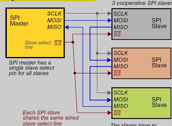

Is it possible to communicate to the slave over share slave select (peripheral chip select line) as per below config without using Daisy-chain SPI bus scheme:
For Example:
LPSPI2 pcs0: PTA9, PTC14, PTE11
like pin PTA9 is used for Slave-1, PTC14 used for Slave-2, PTE11 used for Slave-3.
can someone please share the test project for above configuration using SDK for s32k144 EVB-Q100.
Amarjeet
2,250 Views
danielmartynek
Hi Amarjeet,
I’m not sure if I understand.
All the ports that you mentioned (PTA9, PTC14, PTE11) can be used for LPSPI0_PCS0.
So, it would be as if you used just one PSC0 pin and route it to all the slaves.
Without the daisy chain, all the slave would transmit on the MISO line at the same time.
Could you please elaborate?
